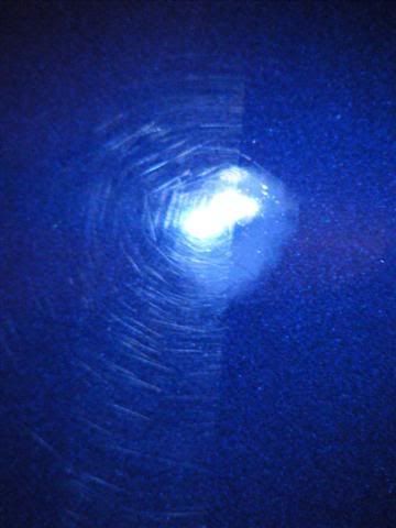

Your car is covered in dirt. This can be dust, grit, mud etc. Washing your car with a sponge means you get to drag these particles across your paintwork. Ever see that spiderweb effect on cars (especially in the sunlight)? That's damage caused by washing.

Remember those spider web effects I was talking about? You remove them through polishing.
^^^ a 50-50 (ie comparison) shot of paintwork correction (shamelessly stolen from another website). Using a machine polish will give you the best correction but most can be reduced by hand polishing. Autoglym Super Resin Polish has both abrasives and fillers. The abrasive particles will break down into ever finer particles whilst also polishing the paintwork. Fillers will help hide some of the swirls. SRP was the best hand polish on DW. The paintwork is built up of layers - primer, base coat, colour coat and clear coat. The clear coat is where the swirls are. It is about 140 microns or so thick (varies from car to car). Polishing will remove 1-2 microns of clear coat, so doing it too often will mean you risk removing the clear coat completely (called clear coat failure). This will require a respray to correct.
