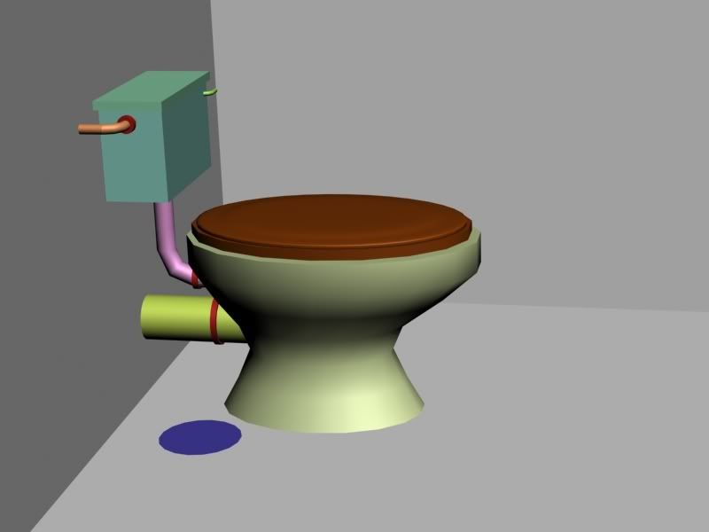

Anyway, over the last few days I've noticed some water on the floor next to the toilet. There doesn't seem to a leak surrounding the toilet so I need to figure out where the leak is coming from, and how to rectify it.

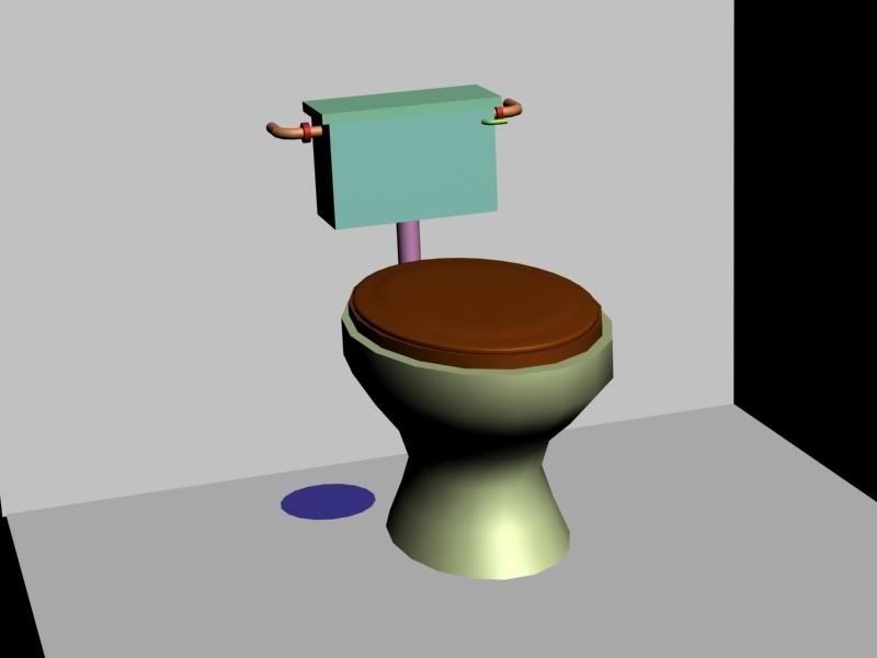

The blue circle is meant to be the puddle. It's very light and barely noticeable but sizeable (about 5-8cm dia). I tried watching it whilst flushing the toilet several times but I can't seem to detect where the water is coming from. The other thing I've noticed is the toilet doesn't flush with its usual vigour. Sometimes the flush reminds me of one of those "ecofriendly" toilets that flush a small amount when flushing urine, except there's only a handle so only one type of flush.
Is there a common problem with toilets that I'm not aware of? Is there a way to detect it, maybe by dying the water in the tank thing?

My first thought, from the position, would be the pipe going into the cistern is not 100% water tight, does it drop slowly? How quickly does the puddle build up?

Is it a continuous leak i.e. does it appear even when nobody uses the WC, or is it flush-related? Assuming the porcelain isn't cracked anywhere, in a WC there's only two or three joints where water can leak from; cistern inlet & overflow, cistern/flush pipe and flush pipe/pan.
Is the pipe connecting to the cistern above the leak the inlet or the overflow? I'd say it's likely to be a slow leak from either the cistern inlet/overflow or where the flush pipe connects to the cistern; if the cistern isn't mounted level on the wall any water would collect and drip off the corner of the cistern that's lowest - I'd guess the left-hand side in this case, and is how you get a puddle in the middle of the floor that doesn't seem to be connected to anything. If the puddle actually extended to the base of the pan (which it could have done, and just dried out at the edges) then it's more likely to be the seal between the flush pipe and the pan that's dicky - though in this case it would only leak when the WC was flushed.
If it's not obvious, then wrap some kitchen towel around the likely joints and see if it gets wet - though allow for condensation as a possible source as well.

I've had a similar problem where the leak was at the L-shape to bowl connection. Only happened when it flushed.
