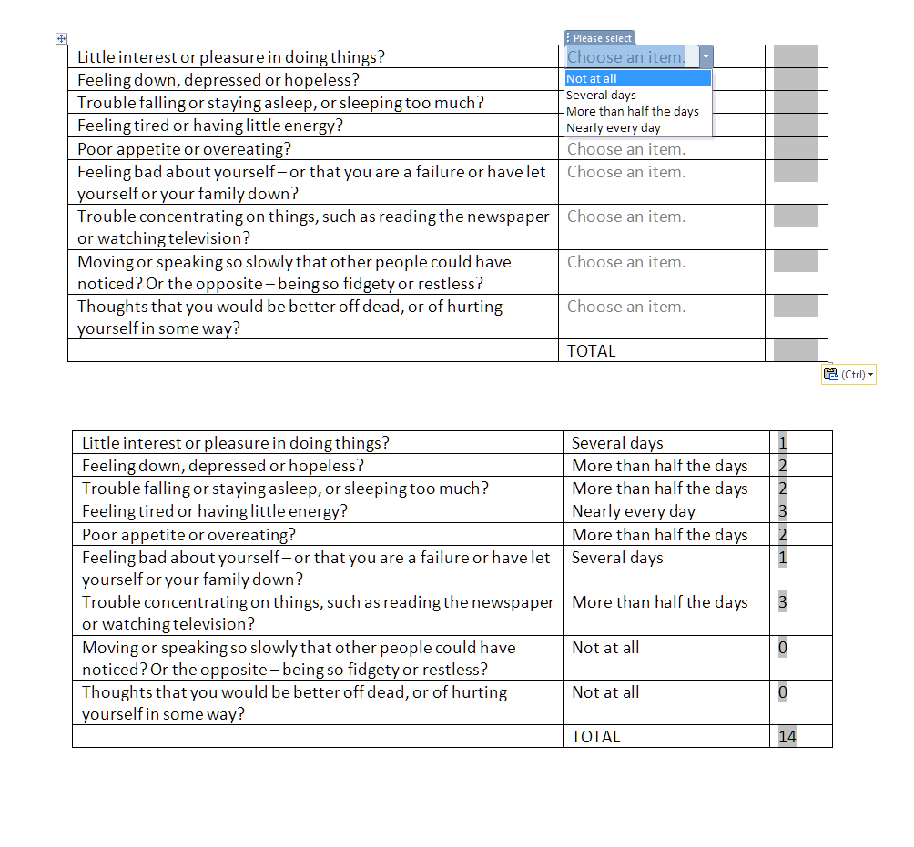

Okay so a pic to show what I'm after:
The first pic shows what the options are. In my head, each one has a score:
Not at all = 0
Several days = 1
More than half the days = 2
Nearly every day = 3
The far right cell should have the value based on what was selected in the middle cell. Total should then sum up the above cells and display a total!
I've looked into this and it goes beyond my programming skills. I've bugger all idea on how to achieve what I want and my google fu hasn't been helpful.

It's in word rather than excel so it doesn't seem to accept formulae or values (unless I'm doing something silly?).
I've done some research last night and so far this is what I've come up with:
Code:
Sub AddDropDownResults()
Dim Dropdown1, Dropdown2, Dropdown3, Dropdown4, Dropdown5, Dropdown6, Dropdown7, Dropdown8, Dropdown9 As Integer
Dropdown1 = Val(ActiveDocument.FormFields("DropDown1").Result)
Dropdown2 = Val(ActiveDocument.FormFields("DropDown2").Result)
Dropdown3 = Val(ActiveDocument.FormFields("DropDown3").Result)
Dropdown4 = Val(ActiveDocument.FormFields("DropDown4").Result)
Dropdown5 = Val(ActiveDocument.FormFields("DropDown5").Result)
Dropdown6 = Val(ActiveDocument.FormFields("DropDown6").Result)
Dropdown7 = Val(ActiveDocument.FormFields("DropDown7").Result)
Dropdown8 = Val(ActiveDocument.FormFields("DropDown8").Result)
Dropdown9 = Val(ActiveDocument.FormFields("DropDown9").Result)
ActiveDocument.FormFields("Text10").Result = Str(Dropdown1 + Dropdown2 + Dropdown3 + Dropdown4 + Dropdown5 + Dropdown6 + Dropdown7 + Dropdown8 + Dropdown9)
End Sub
What I need to do is now give values to each dropdown entry as stated in the previous post. Still looking into doing this. Once this is done, it may well work. I hope!

I think you can embed a spreadsheet but that's different to a table in Word. A table is literally that - some lines. The "cells" are just boxes. No formulae/calculations.
I think it needs to be considered as a form in a Word document, rather than a (excel) table.
Wed May 09, 2012 2:41 pm
Tables in Word can have simple formulas in them.
Thu May 10, 2012 4:33 am
*hits head*
Playing around and I found out the document has to be saved as an RTF so no macros. :(
Means I'll have to find other ways of doing this.
