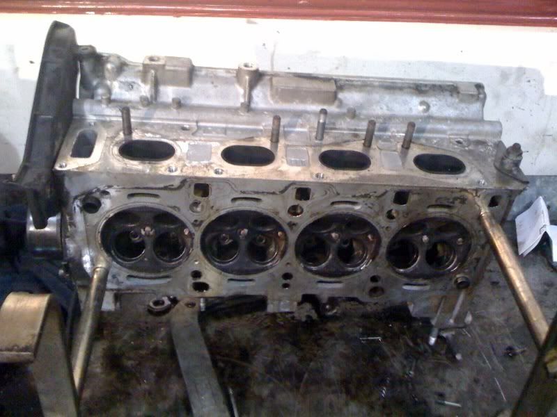

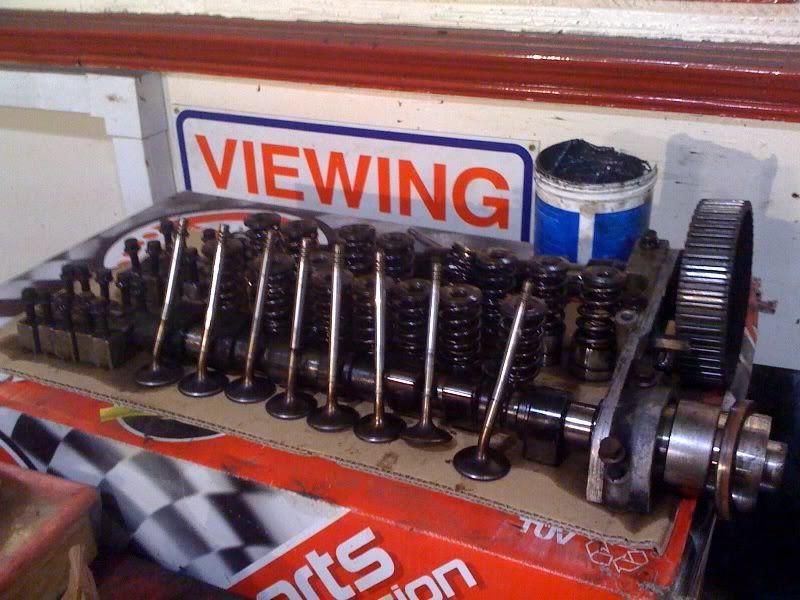

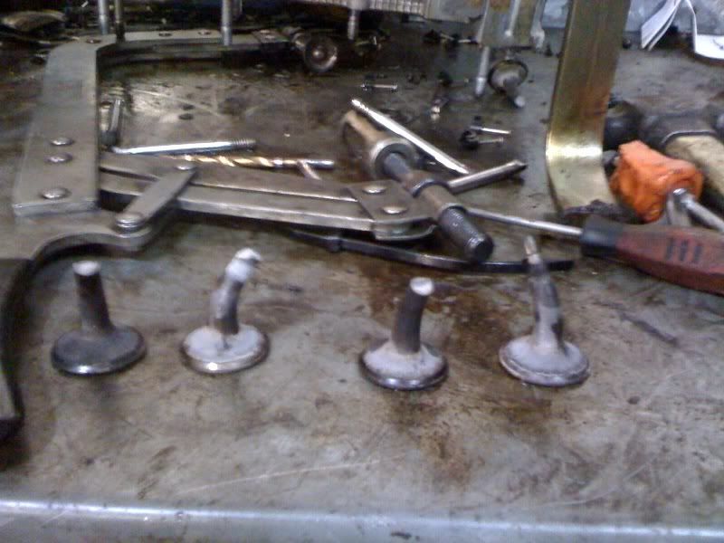

A friend had been putting off a cam belt change in her Alfa.
Some guy who was an AA man told me that Alfa Romeo were the worst cars for breaking cam belts, the AA keep statistics of every breakdown call out. Apparently Nissan are quite bad now for engine failures, but as they are essentially Renaults now, what would one expect !

It's worth sorting them out.
I hope it's not the cup you were telling me about?
As I said, I might have a spare engine, head rebuild's going to be a couple of grand, but would be a better option.

phobos wrote:
No you weren't. The old Carltons all had the same in line engine as the Mantas and used a chain not a belt ! The Omega 2.0 16v, Vectra 2.0 16v has a belt but the 2.2 Vectra, VX220 and Astra 2.2 all have a chain also.
Riiight, but did that mean it imploded? Or that chains never need changing?
Just want it clear in my noggin is all. ;)
Chains do go, but it's very rare.
Alfa's big mistake was changing their famous four cylinder all alloy chain driven 8v engine for a cast iron fiat block. Then speccing poor tensioners, then saying they only need to be changed every five years. That's why the 16v four cylinders are known for going.
V6s are generally better, but ignore at your peril.

Tom, it's not that Cup I was telling you about, thankfully.
Her garage is quoting about £1500 to get the rebuild done.
I should point out that the service interval is (I think) 36,000 and her GTV was pushing 55,000 so it's not to do with 'typical' Alfa build, just a shocking lack of care which would probably have done the same to anything else.
Heather, a lot of Japanese engines are non-interference, which means that if you're cam belt does go, it's just a matter of the engine ceasing to go, rather than exploding.
Jaguar V8s are notorious for poorly specced chains/tensioners as well. One of the first things Dad did to the Sovereign was to swap the chains for the ones from the XJ8 and change the tensioners for the steel ones.
