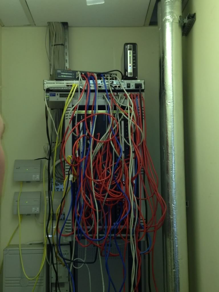

Okay so I got to see the nerve centre today. I took a brief pic and vaguely understand what's going on.
From a quick top-of the-head count, there are around 22 computers in the entire building, all hooked up to this via data point wall sockets. There are around 25 telephones too. I've been told that the inner lot of connections (pink) run to the telephone sockets. The outer set of connections on both sides go to the data wall sockets. The two horizontal boxes are switch boxes. The small box on the right hand side is connected to two security cameras, which can be accessed from any computer via a web log-in. The cable bundle to the top left goes to a raid 5 configured server running Windows Server (I think).
All of the telephone and datapoint sockets are labelled at the wall with their numbers and correspond to the number labelling on the big box.
I plan to create a network map as there isn't one - more for my own purposes.
What else do I need to know? Along with macros in the other thread, my brain is being frazzled by IT stuff. Worse still, I used to know some of this stuff but forgot about it because I never used it.

:shock:
I'm not being funny but whoever left... that... looking like... that... needs a smack. :x
Wed May 09, 2012 4:17 pm
I know. Complete mess ain't it? As stated, it's in the back of the cloakroom. Apparently in the seven years of it operating like this, it's never melted down!
Wed May 09, 2012 4:26 pm
You do realise that you've jinxed it just as you're about to take over?
Wed May 09, 2012 4:28 pm
Probably. Which is why I need all the help I can get, so any advice appreciated.
Wed May 09, 2012 4:33 pm
Actually that's most likely the structured cabling. One cat5 cable going from the patch panel to each socket around the building.
The Siemens box underneath is the phone system, and the two little boxes to the left are 4 lines of ISDN2. Not sure, maybe there's a couple more slightly hidden giving you 8 lines. The larger box to the left is a box-con 301 terminating CAT3 cabling. This may be mostly legacy, or you may have phones running through it. Looks like a couple of "normal" phone sockets there, possibly the internet is on one of them. Is that middle box on top a router? I can't tell from the picture, but it might be something like an SDSL circuit rather than normal ADSL.

It's not an unusually untidy patch panel, although it is the first time I've seen them mounted vertically! Over time, cables get changed and it gets messy. There's actually nothing worse than a patch panel that's been tidied by some anal retard to the point where it's so tight you can't re-patch one cable without practically ripping the entire lot to pieces, possibly shutting down half the company in the process.

Ah! Thanks. There are four siemens/BT boxes, two to the right of the ones you can see and slightly down.
Here's an unedited pic:
Are you able to annotate it for please, so I have some idea of what's what?
There's only one server AFAIK. Everything is on it - all patient records etc. One program (the one giving me issues with form creation) needs a link to its HQ to operate and if that's down, the notes can't be accessed. Otherwise everything else is in-house. Some programs can access other places eg connect to hospital system to order x-rays but no one except my boss uses this.

That picture is a little clearer - looks like the phone system actually says Samsung.
At work right now, but I'll annotate tonight.

Okay so I went took down some details of what I could see.
There are seven small boxes on the left side (four in the pic, three further down that are hanging rather than affixed!). Six of them are lit and the seventh isn't. They state "BT" and "ISDNe".
The top horizontal box: SMC EZ switch 10/100
The second horizontal box doesn't seem to have any markings on the back.
The third horizontal box: HP Precurve Switch 2124 or 2129 or Z124 or Z129 (I can't read my writing!)
The big box with the cables: Pressac - the sockets are labelled 1->96
The bottom box: Samsung DCS Compact II.
