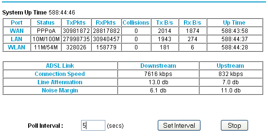

Netgear DGN2000  Ignore WLAN up time, I have just enabled it. But the router hasn't been switched off for approx 22 hrs. I haven't tried the test socket yet.

When you do, note the dB levels - another screen shot would be good. For attenuation, lower is better. For noise margin, higher is better. Despite having 6dB higher attenuation than me, your noise margin is 4dB better. That's excellent, as represented by your 8128 kbps connection speed - the maximum possible on an 8Meg profile. If your exchange is ADSL2 enabled, then you could probably get a lot more with a 24Meg profile. Check several times each day. Do they vary? Do you lose sync occasionally? However, it shows you've only been on-line for 1:45 on both the LAN (internal network) and WAN (ADSL) ports. Is there a reason your LAN connection would have dropped at the same time as the WAN, given that you say it's been on for 22 hours? Is the ADSL set to stay connected all the time? If not, then change it so it is. Have a look in the log. Every reconnection is in there, so you can see exactly when the router last reset and when the ADSL dropped. If the router is randomly rebooting, then it is not a line fault.

I have just changed to a different package with my ISP, which was activated on Tuesday, I think. 4.50pm on the 16th Dec.  9.40am this morning  7.37pm this evening  I have decided to replace the telephone wire from the master socket to my computer room, and I have a good few metres of the cable pictured below. I take it, this is a better bet than the flat stuff?

The router stats look absolutely perfect. Have you had any trouble over the last 10 days?
