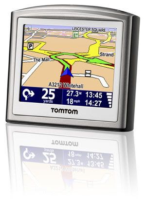

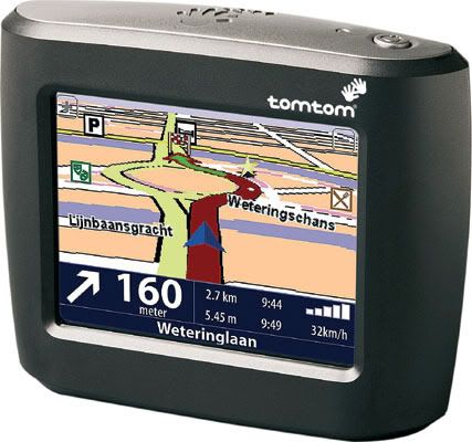

Serial nos don't help but a pic might.
Version 1
Version 2
Version 3
Tue Nov 10, 2009 10:56 pm
It's a version 2 and I am making some progress. It now start up but says that there are no maps... I am currently updating the application, and if needs be will try and download the map again. If not from the TomTom site then maybe somewhere else...
